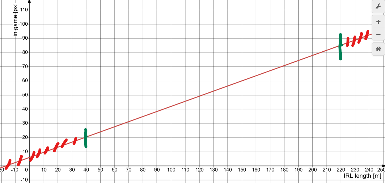

Ships for ship sizes between 40m-220m
Ships have a new approach: a scale equation: y ≈ 0.36x + 6
All these ships should be in 45deg on the sprite.
Ships for ship sizes above 220m
shoud be in "air carrier" angle like in AOMW
ships above 220 (like aur carriers) should use fixed scale 0.26 : so 0.26 pixel / Meter.
